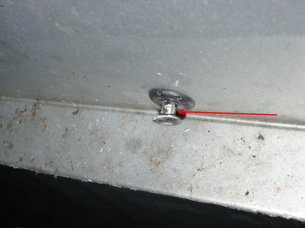

4. Remove 3 panel fasteners from the underside of the bumper nearest the plastic sump guard (fig #4). I found the easiest way to remove these was to gently prise the central pin out with a small thin bladed electrical screwdriver. (close up fig #5) Then pull the pin free with long nose pliers. The plastic cup is then easy to pull free.Fig #4
Fig #5
